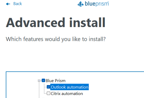

Try re-running the installer and choose Change Features
John Carter
20-02-24 01:26 PM
Thanks John carter for sharing the screenshot. I totally forgot it is present in the BP installation.

Versions of Blue Prism prior to v7.3 included the Outlook interop DLL if you selected the option at install. If it's not in your folder, it's likely that you didn't select that option during install.
Starting with v7.3, the Outlook interop DLL is no longer included due to licensing restrictions. In its place is the NetOffice Framework equivalent. However, the be able to leverage that Outlook integration you will have to download the NetOffice version of the Outlook VBO from the DX. You can find that here. All of the action names and even the VBO name and object ID are the same, so you shouldn't have any issues with existing proceses that use the legacy Outlook VBO.
