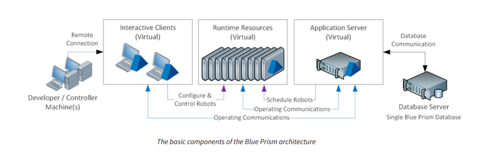

Yes you are right , As per Blue Prism Architecture All bots(Run time Resources) and development machines(interactive clients) are connected via application Server
Typical installation will have
1) 1- Machine for Blue Prism Database (Microsoft Sql server)
2) 1- Machine for Blue Prism Application Server (Connects to BP Database)
3) 1 or Many Development Machines(Interactive Client in BP terminology) connected Prism to Blue Application Server
4) 1 or Many Bots (Runtime resources in BP terminology) connected to Blue Prism Application Server
So everything is gets stored in Blue Prism Database (process, objects , users, environment variables etc) and Application server is main component through which bots/developer machine talk to BP database
Below is architect diagram
