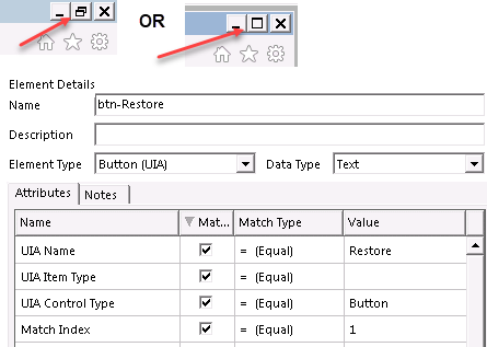

​John,
Maybe not exactly what you want, but I have been successful in spying for the Maximize button at top right of the browser window. As a button (UIA) it has the name Maximize or the name Restore depending on which state the window is in at that time. Use Verify from Navigate stage to know which button is present.
Steve Narkis
