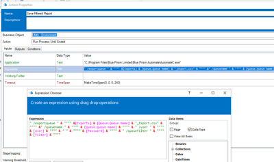

Hi @hantao @Nandhakumar If you are using sso you can export using this command.
If you are using a non sso, you need to make sure the user id which you have logged in to export the reports should have access to export reports in blue prism. and you can use the below logic for this in blue prism.
Argument : " /exportqueue " & """" &[Exports] & [Queue.Queue Name] & "_Export.csv" & """" &" /queuename " & """" & [Queue.Queue Name] & """" & " /sso " & " /queuefilter " & """" & [Filter] & """"

2 weeks ago
can you please share dummy data/value of each data item from this
