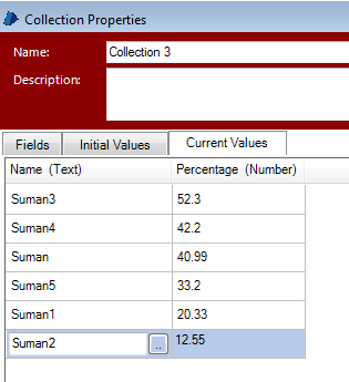

I have a collection which is a final collection after using sort collection. From that final collection, I want to filter only "n' rows for example only Top 3 from that collection.
So my final output collection should look like
1. Suman3 - 52.3
2. Suman4 - 42.2
3. Suman - 40.99
Could someone please help me on this?

In that case you can copy those number of rows to another collection, by using copy rows action stage in Collection Manipulation VBO. Add as many rows you need. Refer screenshot.
Let me know if it is not clear. It will work.

The code stage within "Filter Collection" currently only uses the DataTable.Select() method, which does not support this. However, you could make a clone of this action and supply an input for number of rows you need. This will also require some changes to the object dependencies, which I'll list below.
In code options, add to External References:
System.Data.DataSetExtensions.dll
System.Core.dll
System.Linq (It boggles my mind that this isn't in here to begin with, but that's neither here nor there.)
Add input:
number - Number (Specifies number of top rows to pull)
Change line 3 to:
Add to ln 13:
Edited to take top rows post-filter instead of pre-filter
