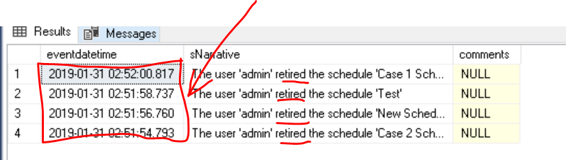

If you are good with SQL, You can probably write a SQL query on [BPAAuditEvents] table
SELECT [eventdatetime]
,[sNarrative]
,[comments]
FROM [dbo].[BPAAuditEvents] where sNarrative like '%retired%' order by [eventdatetime] desc

04-02-20 02:19 PM
Thanks Vivek!
