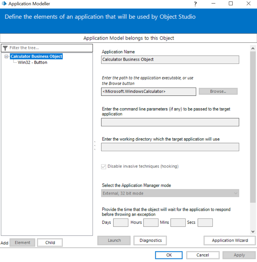

Can you check once if you are using the below application modeler configuration at your end:
You can try changing the '
Application Manager' mode if it does not works but the executable path must follow
<Microsoft.WindowsCalculator>. The reason being is that with Windows 10 style applications, you need to give a different executable path such as Alarms, Calculators etc. To get a list of such path names you can use a powershell command:
Get -AppXPackage -AllUsers | Select Name

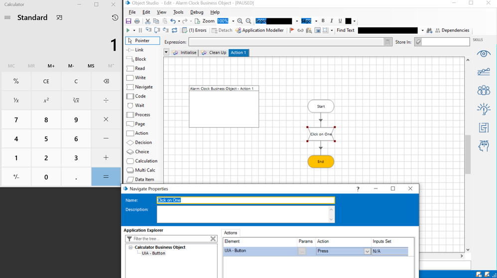

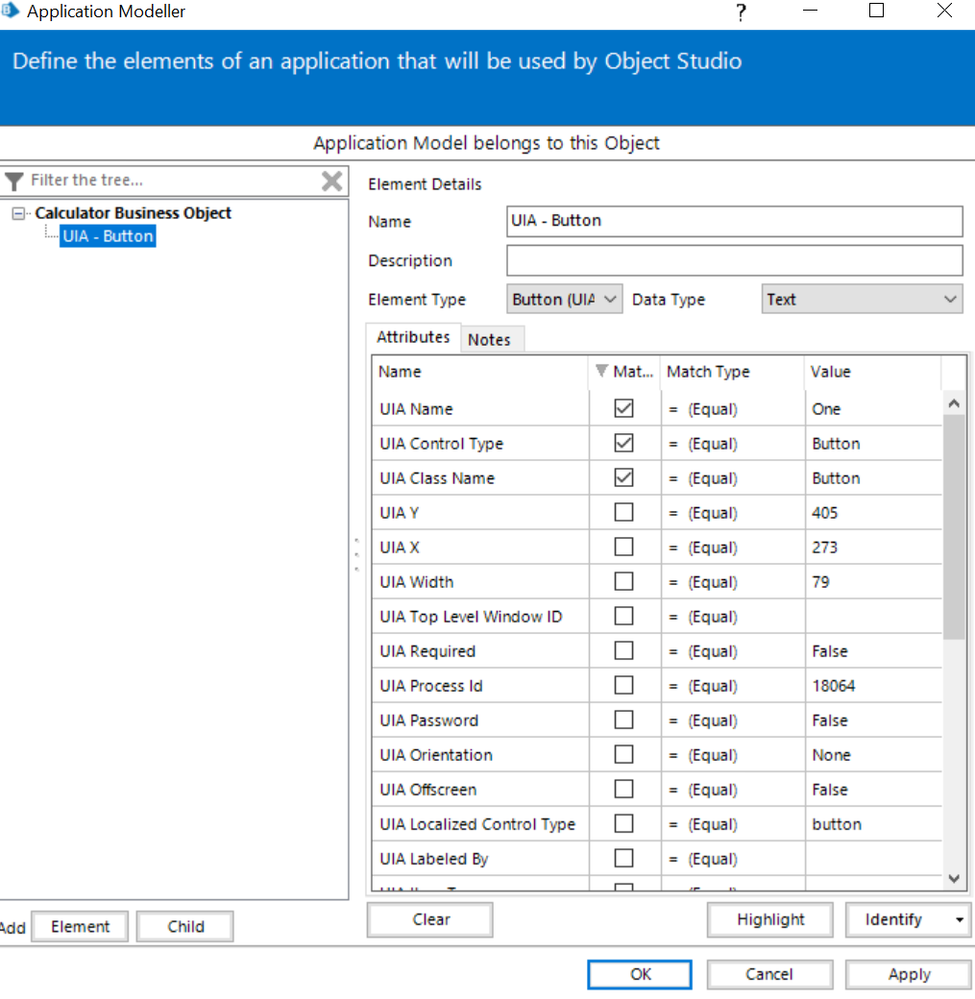

Once you have configured the application, use UIA mode to spy elements as I saw it to work best as shown below:
Now if you use any action on it, it should work:
