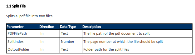

Please refer this DX PDF Management VBO located at: https://digitalexchange.blueprism.com/dx/entry/3439/solution/pdf-management-2, you can set the index upon finding the string to split in the PDF and Split accordingly. I have used this VBO for merging PDFs and it will require you to add PdfSharp.Dll in the automate folder (C:\Program Files\Blue Prism Limited\Blue Prism Automate) along with all the Dll.

I thought that it can split the document only based on the page number.
Could you elaborate a little bit as to how to set the index upon finding the string?

Hello HongJoo Choi, Apologies I couldn't keep a track on the follow up questions you had - the above DX Object can split a PDF ( https://digitalexchange.blueprism.com/dx/entry/3439/solution/pdf-management-2) basis on Page Index - So we comedown to the initial part as per suggested solution I mentioned - which was to search in the PDF content for a particular string and locate the Page number and Page Index (PageNumber -1) - above said DX asset uses PDFSharp.Dll which also has the capabilities and functions to do string search, just that you would need to be aware of the functions and how to use them but I already have built something to cater this same requirement with iTextSharp.dll.
Recently we had a similar requirement and have to built a similar object just to return Page number as output basis of specific string we were looking in the PDF, Page index could be calculated further as Page Index = "PageNumber -1" - I will attach the Object and the Dll along with it (iTextSharp) - which will help you to find the Page Number and Page Index for given search of string in the PDF and post that you can simply use the above mentioned DX PDF management Object to split the PDF basis on the Page Index.

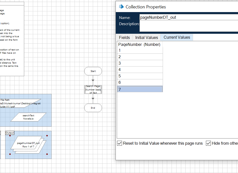

Hi @HongJooChoi - <pageNumberDT> is a validation checker for code and is meant to be left blank. The code will return the page number where the strings have appeared not the number of occurrences of string on the same page. I am not sure if in your case the Searched string is in 3 lines but on the same page which is page number 2.
I did check with one of the PDF (attached is the sample PDF only its not a guide) where "search string = Novelis.io" and "extractionStrategy was left the as default = 1"
Here's the output for that(Returning the Searched Text and their occurrences on page numbers, which can be further calculated for Page Index and passed as Input to Split PDF basis on these calculated Page Index(Page Number-1):
