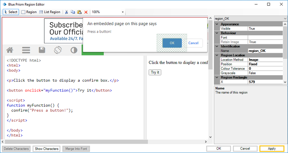

jegendra
Hi Thang,
For this example, you could spy the OK button using the Region Mode.

Hi Jega,
Thank you for your support.
I could spy the OK button using the Region Mode.
But because Region_OK position is fixed, so i think i can't spy OK button in the following cases.
1. Chrome Window is resized.
2. Object is used in different Runtime Resource.
Thanks in advance!

Hi Michal,
I hope you've got the answer already.
Some reasons, my response was posted with delay.
Please refer to the screenshot below.
Jega Avinasinathan
