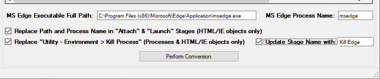

Hi Deepika,
Were you referring to the Process Name and Path in Attach/Launch stages? If so, did you check the following option highlighted?

Hi Bruce,
Yes, the below options were checked.
After conversion, the new release did not have any changes.., not just the attach and launch stages, the App modeller was also not updated.
Deepika Prashanth

28-04-22 11:55 PM
Hi Deepika,
Thanks for reaching out and much appreciate for your feedback on the utility. This has helped resolve the bug that was not uncovered before.
The new version of the utility is now on the DX. Please kindly check to see if it resolves your issue.
