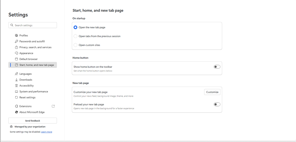

Since November last year, we have started having issues where Edge reopens tabs from previously closed sessions. This is causing problems with processes being able to log into applications. We have made sure all settings in Edge are set appropriately to load a new tab each time but no matter what settings we select, the previous sessions tabs are loaded as well as the new tab.

We haven't seen this issue as far as I've seen. Are you 100% sure that the settings are correct? I mean, I believe you, but I'm asking you the same question I'd ask myself in this situation just to make sure.
Maybe screenshot some Edge settings, and I can go look at our settings as well to compare to.

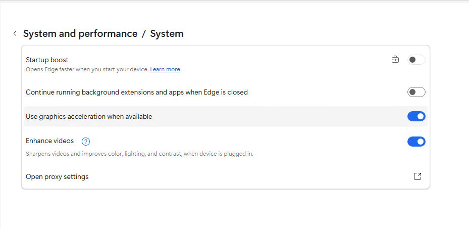

Another thing to check might be Startup boost. I feel like it shouldn't cause this, but I could imagine a world where Microsoft makes Startup boost keep tabs open in the background even when you close the browser. To avoid this issue, you could either disable Startup boost or always kill msedge.exe before you launch it.
In the end, what I would be very curious about is whether you see this issue even after the msedge process is killed. And if it still happens then, that's when I'd try InPrivate mode. Honestly InPrivate mode prevents a lot of issues. The only real downside that I've found is that the toggle in the extension settings that enables the browser extension to be used in inprivate mode will randomly turn itself off. We have an automation called Set Up MS Edge that we use to run daily on all machines to toggle this setting if it turns off as well as verifying/setting like 20 other various MS Edge settings because we're too lazy to find out how to do it the correct way. 😃

I have attached images of the settings we currently have set showing all of the suggested settings are switched off/accordingly but still getting previous tabs loading. To note, this happens primarly if we have force closed msedge. We have not yet tried running with an InPrivate session but try this as a possible workaround but would really like to know what has caused this to start happening and a permanent solution if possible. Thanks for your swift reply

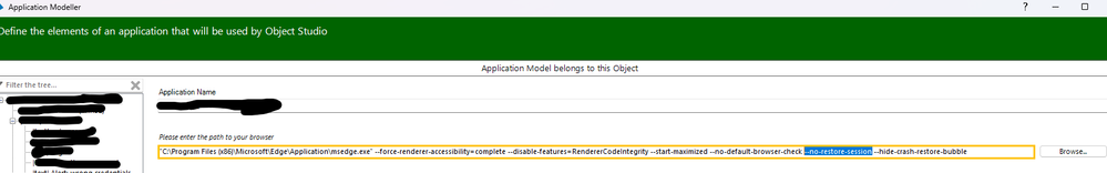

We ran into this issue as well.
Solved by adding extra starting switch "--no-restore-session" to App Modeler.
