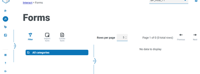

AngelicaGarciaH
Hello, I have a problem with Interact because when I enter HUB and go to Forms, the Create Form option is not active and neither is the Import form option, could it be that I am missing some configuration, is it about the license or what is the reason? I hope you can help me.

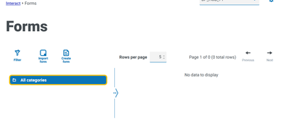

AngelicaGarciaH
Thank you very much for your answer, I have managed to activate both options but I still don't have data in categories, is there any way to add them? Do you know if there is a guide to perform these previous steps?

AngelicaGarciaH
I have found that the way is to type the desired category and that way they are added to the drop down list.
I am attaching the link that has helped me for anyone who needs it.

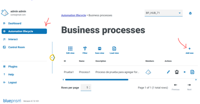

AngelicaGarciaH
Hi Allan, I just added a new process in the Automation Lifecycle section, I attach a screenshot as an example.
Regards!
