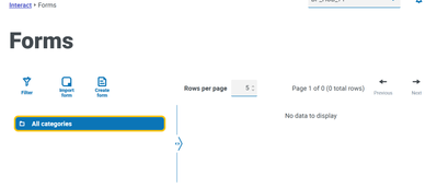

Hello, I have a problem with Interact because when I enter HUB and go to Forms, the Create Form option is not active and neither is the Import form option, could it be that I am missing some configuration, is it about the license or what is the reason? I hope you can help me.

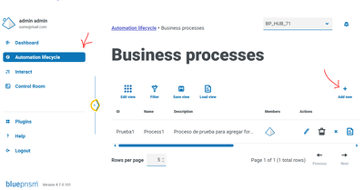

Hi Angelica
The only way I was able to create a form is to create a Business Process first in Automation Lifecycle, then when on the forms page the Create Form icon is active.
Seems to allow only one form per process.

Thank you very much for your answer, I have managed to activate both options but I still don't have data in categories, is there any way to add them? Do you know if there is a guide to perform these previous steps?

AngelicaGarciaH
I have found that the way is to type the desired category and that way they are added to the drop down list.

AllanRo
Hi @AngelicaGarciaH
Did you also follow the process of creating a business object first before this icon became available?

AngelicaGarciaH
Hi Allan, I just added a new process in the Automation Lifecycle section, I attach a screenshot as an example.
Regards!
AllanRo
Thank you Angelica 🙂  it worked!
