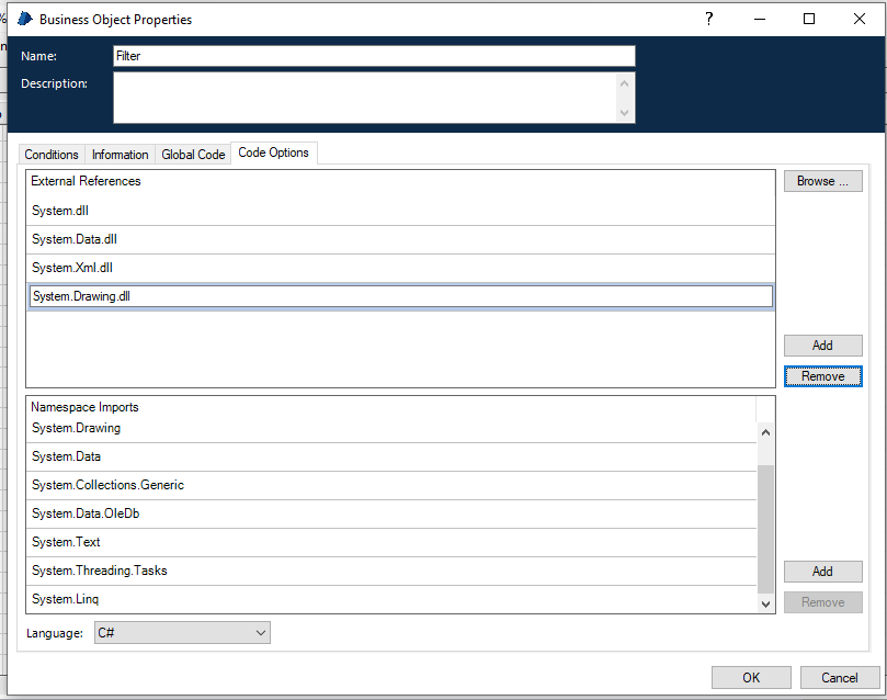

I am using code Stage and i have written code in C# .
I am getting following error:
Page: Initialise
Stage: Stage1
Type: Error
Action: Validate
Description: Compiler error at top section line 7: The type or namespace name 'Linq' does not exist in the namespace 'System' (are you missing an assembly reference?)
Repairable: No
Here is my Code:
string strSummaryFileName = "E:\\VElement\\filterinputs\\v2 Headcount Summary (LnD)_with Staff Movement.xlsx";//Get the variable from BP
string strFunctionalTitleFileNm = "E:\\VElement\\filterinputs\\Functional Title.xlsx";//Get the variable from BP
string strTitleSheetName = "M2 Only";//Get the variable from BP
string strFileExtension = ".xlsx";
DataTable dtHeadCountSummary = ReadHeadCountSheet(strSummaryFileName, strFileExtension);
DataTable dtFormatedSummary = ChangeTheHeaderNm(dtHeadCountSummary);
DataTable dtFunctionalTitle = ReadFunctionalTitle(strFunctionalTitleFileNm, strTitleSheetName, strFileExtension);
DataTable dtReportData = FilterHeadCountSheet(dtFormatedSummary, dtFunctionalTitle);
I have added certain dependencies.
PFA
Plase help me to solve this error.

The basic answer is that you need to remove the class and method declaration in your Code Stage, since they aren't needed. Read below for the long answer.
Here's a few things that will help orient you toward understanding how to put code in Blue Prism.
  1. Code stages can only contain the body of a method, not the class or method declaration. Think of the Code Stage itself as a static method that is part of the class of YourObjectName.
  2. You can only declare classes and methods inside the Global Code, which you can find in the Initialise page inside the Settings stage.
  3. You do not need to declare a class in the Global Code in order to declare a method, however it does work to create classes with methods inside.
  4. If you create a method outside of a class in the Global Code, it is effectively a static method and so no object instantiation is necessary. You can just directly call on it from anywhere (depending on the access modifier, such as public).
  5. To pass inputs to code, you actually declare the variable datatype in a Code Stage's input/output tabs rather than in the code itself.
  6. You never need a Main method because a code stage is executed if the process flow reaches it.
Option A: So, the easiest way to do what you have above is to drop the following code into a code stage, and you're done (of course the string inputs are not dynamic at this point):
DataTable dtReportData = FilterHeadCountSheet(dtFormatedSummary, dtFunctionalTitle);​
Option B (part 1 of 2): If you want to use the class and declare a name for your method so that other code stages in the object can reuse the code, then put the following code in the global code:
class Program
public void doExcelStuff()
Option B (part 2 of 2): And then create a code stage on a page/action within the object. And inside that put this code:
Program program = new Program();
program.doExcelStuff();​
Option C (part 1 of 2): If you don't need to worry about the class declaration then it's a tiny bit easier. Put this code in the Global Code:
Option C (part 2 of 2): Put this into a Code Stage:
doExcelStuff();​
