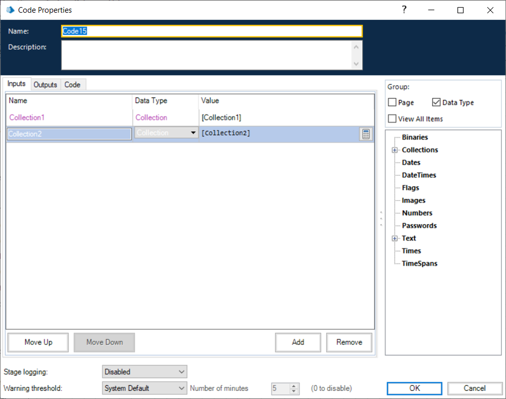

On the
differences error, did you define an Output data item names
differences too? If so, that's the cause. Basically you have an Output variable with the same name as the internal
var differences variable you defined in the code. If you refer back to my example, I used a capital "D" on the output data item. It makes a difference, no pun intended, because of case sensitivity.
For the first error, I'm not sure on that one. Would you post a screenshot of your
Code Options page?

Apologies for the delayed response. I was out of the office today. There are two DLL's you'll want to reference:
- System.Linq.dll
- System.Data.DataSetExtensions.dll
For Namespace Imports, you'll want to include
System.Linq.

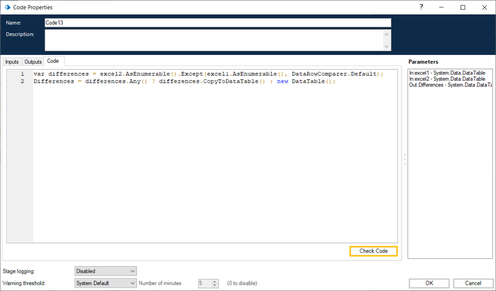

So you want to flag rows that contain the same column values but are not in the same overall order between the two spreadsheets too? In your example above you call out the 3rd row of Excel1 where column B = 24 but the 3rd row of Excel2 has column B=26. The only issue here is that the rows from #3 onward are in a different order between the two collections. Would those then be flagged in your differences collection?
The following code will perform a comparison of two DataTables and return a DataTable that contains the actual differences between them. However, this is looking for actual differences in DataRow objects. If the rows are simply in a different order, they don't count as a difference. That's just a sorting issue. The only way a DataRow is actually different is if it contains completely different field values.
Here's the actual code:
var differences = excel2.AsEnumerable().Except(excel1.AsEnumerable(), DataRowComparer.Default);Differences = differences.Any() ? differences.CopyToDataTable() : new DataTable();
