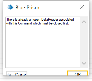

I am using Blue Prism on VDI and VDI is getting allocated dynamically whenever I login to VDI. I created an Object to do some testing for a particular application and in between the development my Blue Prism application got stuck and got closed. I restarted the VDI and tried to open my object which I created but I am not able to open the object because it is giving error message of already opened in edit mode. I tried to unlock object forcefully but still I am not able to unlock my object as it is still locked in other VDI with my Blue Prism account.
I am getting below error message when I try to unlock my object.
"There is already an open DataReader associated with this Command which must be closed first."
Please help to get the solution for this issue.

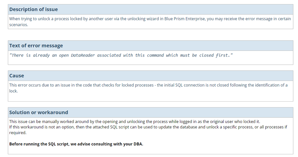

HI Amit Gupta,
Here is the knowledge base article regarding this error, Looks like this error exist in BP 6.8 version onwards
https://support.blueprism.com/en/support/solutions/articles/7000079879-bpe-error-there-is-already-an-open-datareader-associated-with-this-command-which-must-be-closed-firs
Attached screenshot for the issues, As mentioned by other member it need to be unlocked by the original user.
