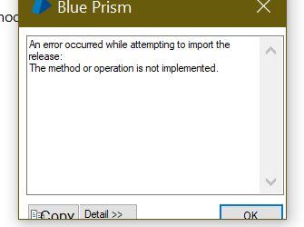

As we have Configured webhook on teams.
Can you please help or steps to us in establishing connection on MSTeams with webhook.
We have also tried to import package from below link but few are facing error.
https://digitalexchange.blueprism.com/dx/entry/3439/solution/microsoft-graph-api---teams.

Hi @SHUBHAM JAIN,
Couple questions:
Couple questions:
- What version of Blue Prism are you using?
- When you say you've implemented a webhook in Teams I assume you're looking to have Teams send a notification to a digital worker. Is that correct?

Hi Eric,
Currently we are using Blueprism ersion 6.3.0.6190 and we need to use teams chat for alerts sending for the application.

Hi @SHUBHAM JAIN,
Ah, there's the problem. The MS Teams connector was developed using the Web API services feature that was introduced in Blue Prism v6.4. That's why you're having issues installing it.
