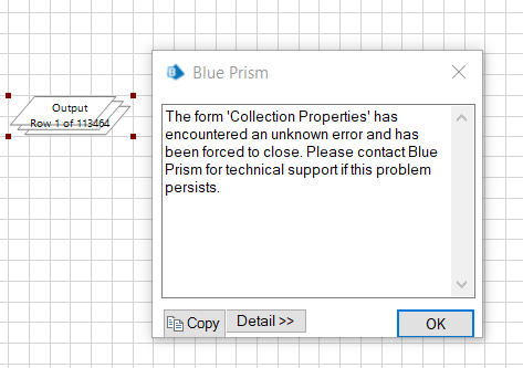

Hi, I have a excel file with 100k+ rows and 16 columns. I imported it to BP collection, the file was imported and collection shows row count, however I am not able to open the collection. Please suggest what is the best way/data structure to store huge volume of data in blue prism at run time..

Hello Mayank,
It could be that the data collection is simply too large to load all at once. If you are already running into size issues when loading the data, there is potentially other problems that you will run into down stream as well (for example, if you are loading data into a work queue, you may encounter a network timeout because the Add to Work Queue operation takes too long on the network.)
One best practice is to try to trunk the large input file. This would not only fix this problem (which could be Blue Prism unable to allocate enough system memory for the whole data collection,) but also improve the overall resilience and performance of the final business process.

Any data structure of .net which can handle large volume of data from excel/csv etc and can perform operations on it will be helpful.
