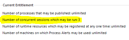

​Thank you, We have a license for 3 sessions, we have scheduled only 1 process in schedular and will run every 15 mins.
And we have only 1 runtime resource,  so I guess we have a compitable license.

Can you verify that you're able to creating 3 pending sessions concurrently? Just drag and drop some processes onto your resources so that it adds up to 3. When you drag and drop the 4th, it should give you an error similar to what you saw before. But this would be a good test to verify that Blue Prism is correctly freeing up the license availability after each session ends. This can sometimes happen if a session is stuck (will show 'Warning' in recent versions of Blue Prism) or if a session is pending from way back and you just don't notice it.
