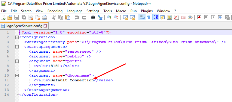

joakimeklund
Level 6
Have you changed the Login Agent config file in C:\ProgramData so it has the right connection details?
/Joakim

John__Carter
To add to Joakim's advice, see below. Also check the r/w permissions on the file; occasionally I've seen it where permissions on the file are restricted to a particular user (the one who created the file) and other users cannot edit it.

Hi Joakim,
Unfortunately the config file​ is hidden and I cannot see it.  I have contacted our IT to take a look.  Hopefully this is just as simple as changing the connection details and there is nothing else I need to fudge around with.
I'll get this done and come back.  Thank you for the suggestion
