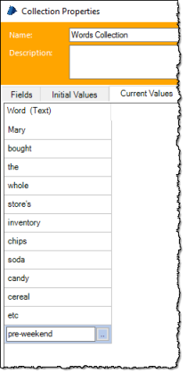

12-08-22 03:50 PM
@NayanaH_P
You can achieve this with two actions in the Blue Prism "Utility - Strings" VBO:
Taking the following sentence:
We can perform the following steps on it:
Micheal Charron
Senior Manager
RBC
America/Toronto
- Use the "Regex Replace" action to remove all punctuation in the sentence with the regex pattern "[^\w\s\-']" which tells the action to ignore word characters, spaces, apostrophes and hyphens. Anything else will be replaced by an empty string.
- Use the "Split Text" action to take anything left over from the previous action and separate them, by space, into a collection:
Then you end up with a collection like this:
