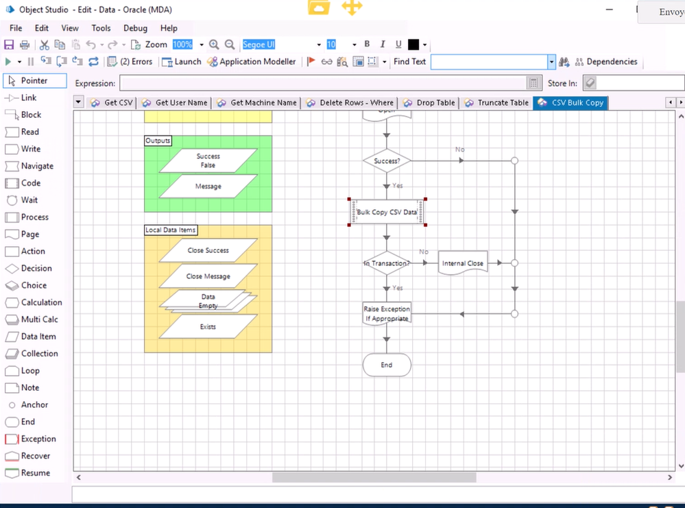

But I have faced the following problem with the "Bulk copy Csv" stage
Error details :
Stage: Bulk Copy CSV Data
Type: Error
Action: Validate
Description: Compiler error at line 7: The type or namespace name 'OracleBulkCopy' could not be found (are you missing a using directive or an assembly reference?)
Repairable: No
can anyone help me to solve this problem ?

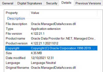

Firstly, can you check that you are using Oracle V21c or later? This feature requires at least that version of Oracle to work correctly. Resultantly, you may have a previous release of the managed data access dll.

GeoffHirst
Sorry the image above is a little small. This is the details page of the DLL and it shows the version you need.

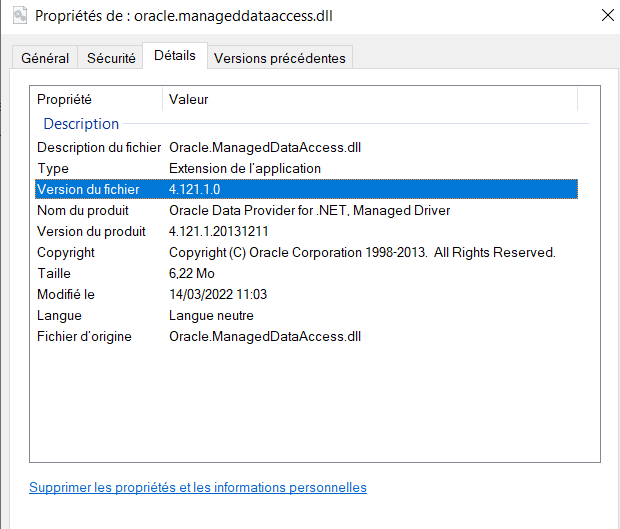

Hello Geoff
Here is the details page of the dll I am using.
20265.pngI have downloaded it from the following link :
https://api.256file.com/download/6150_oracle.manageddataaccess.dll
Thank you.

Hello Ghaith,
The version I have came from Nuget. You can get it here https://www.nuget.org/packages/Oracle.ManagedDataAccess/
This might only be familiar to you if you are also a .NET developer. The file that you will get from here is a filetype of nupkg. Please let me know if you need any further assistance with  working with this file.

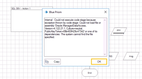

Hello Geoff,
Thanks, I have downlaoded the file from nuget. then I have extracted the dll.
I no longer have the Bulk copy error or any other error on the MDA oracle object.
I started to set a connection
but then when I launched a simple querry I got the following error.
20273.pngAs I was debugging step by step I found that the error appeared in the following stage :
Thank you for your help.
Ghaith Abdessalem
Ghaith,
This kind of message is prevalent when Blue Prism cannot locate a DLL. Now, what I would ask is, did you install the nuget dll into the Blue Prism folder whilst Blue Prism was running?
What I would suggest is to close down Blue Prism, retry and let me know the outcome.

Thank you a lot Geoff,
I got my first querry running with the MDA function !
