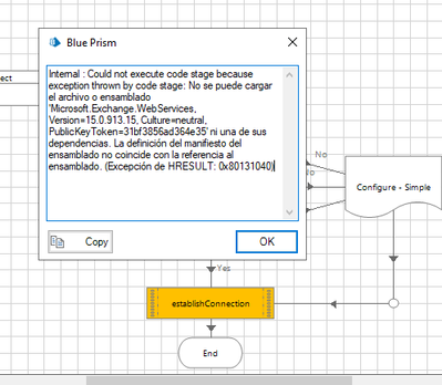

Good afternoon! I'm facing an issue at a client project.
I want to work reading emails by using MS Exchange WS object on a Windows 10 VM. At the moment of connection, the object throws the error:
HRESULT: 0x80131040
The dll file required to use this object is installed on the main path of the Blue Prism folder, and dependency is correctly defined on 'Initialise' page.
I've tested this on a W7 VM and just works fine, but for the project we cant use this machine.
I would appreciate any help you can provide if you found the solution to this problem.
