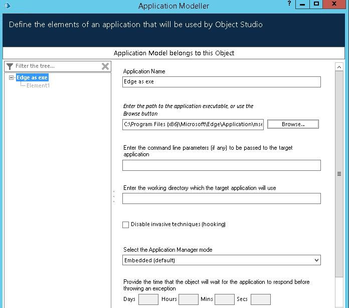

The model that you have above is for a browser, when set as a windows application you should see slightly different options, as shown here;
Chris Cutting

Quick update on my findings, Chris Cutting mentioned using Edge as an object on its own set up in windows application mode.
What i found was that if i close Edge in a browser object i get the extension not installed issue when trying to Launch edge again.
So what i did was create a separate object  for MS Edge in windows application mode that Chris suggested and created a page that just launches Edge and closes Edge.
I then tested this buy creating a process that opens and harshly kills edge 3 times using an action that points to MS Edge in Application Mode (Launch>Wait> Kill>Wait> x 3), and it launched it successfully each time with no extension issues.
I then created the exact same flow (Launch>Wait> Kill>Wait>) x 3  in the process using an action that points to MS Edge in Browser Mode, the first Launch was OK, then it killed Edge and low and behold the next time it tried to launch Edge i had the extension not installed error.
I created a stand alone object so in a process where i use Edge in browser mode, on my close / terminate edge page i add in at the very end an action that points to Ms Edge set up in Application Mode to open and close the window before it reattempts to Launch again in browser mode.
When added to the processes i was having issues with it worked and i no longer received the Edge extension issue.
So it seems that when you close Edge in browser mode it does not always release the extension regardless of how Edge is closed down and regardless of any wait stages, but opening and closing it in Windows Application Mode forces it to be released.
I have attached the Ms Edge Object i created in Windows Application Mode as Release to Launch & Close Edge (as a txt file just rename the file extension .bprelease), feel free to use it. Just add it in as an Action in your MS Edge Browser Object. (See my example below, Ms Edge Application Mode highlighted in yellow)
