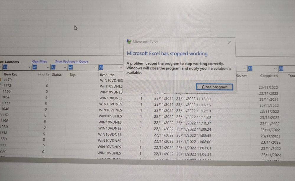

Hi
Please find the attached image of excel pop up which is arising,
close excel will happen every time when I run the process,
In debug mode I'm not facing any issues of this popup , only while running in control room

Hi Soumya,
This strikes me as not being a BP or process problem, but XL crashing for some reason. That said, does this always happen at the same process/object stage? What does the log from the Control Room run say?

Soumya21
Hi Paul,
This happens irrespective of object stages; it can occur in any of the Excel VBO actions performed.
The logs sometimes it comes as RPC error or code stage error

@Soumya21
As Paul also mentioned it doesn't seem like a BP process related issue.
Are you running in debug mode and control room on the same machine? Have you tried running your process in another VM?
Also you may check if any Excel Add In is causing the Excel to crash?
Here is an article on troubleshooting steps to resolve Excel not responding error,
https://support.microsoft.com/en-us/office/excel-not-responding-hangs-freezes-or-stops-working-37e7d3c9-9e84-40bf-a805-4ca6853a1ff4
