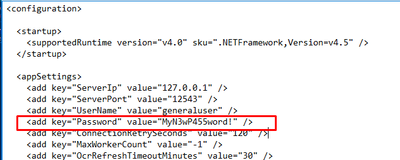

For each file:
- Make a backup of each file. Just in case.
- Edit the UserName value to update the password as per the screenshot below.
- Close and Save the file

NOTE: If encryption was already applied during installation, or otherwise, and you need to change the password simply make the value of the UserName field plain text, for example:
<add key=”Password” value=”MyN3wP455w0rd!”
Then re-encrypt the file as per the instructions above.

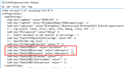

For each file:
- Each file has the RabbitMQ configuration in the same syntax. Simply change the credentials to suit as per the example below.
- Save and Close the file
Note: If the web.config has encrypted values simply copy the lines from another file, the format is consistent across all three files.

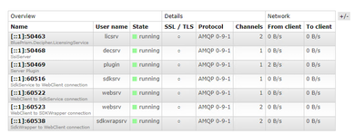

To check if the guest account is still being used by Decipher:
- Ensure Decipher is in use to ensure all components are currently running
- Browse to the RabbitMQ management portal, usually http://localhost:15672/
- Go to the Connections tab
- Each connection can be seen to be running under a certain user name
- The example below shows were each component has been set to under a separate RabbitMQ account. It can be see none of the components are running under “guest”
Provided your Connections look like the above it is safe to assume the guest account can be deleted if required.
