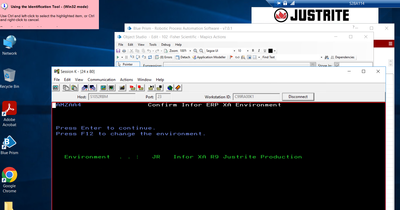

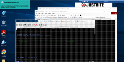

when am trying to spy the outer window of mainframe it is directly converting into gridview mode which we can spy the region of the Mainframe screen. can some please help me out. how to spy the outer window of mainframe using blue prism
first when start spying the mainframe it showing me win32 mode as below
Once i click on the window, it directly converting itself into grid view mode without press Alt button to chnage the spying mode as below, can see the grid mode is coming from the window rather than from black screen

you have to create separate object, in application modeller you can select the windows and attach to the mainframe application then only it will work
you can't do windows action directly in mainframe application setup
we are also doing this, we have created separate object, attached to mainframe application
