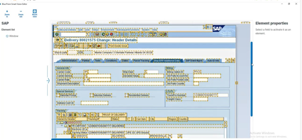

I understand that you are facing difficulties in connecting and interacting with the Whole Connection Terminal emulator using Blue Prism, and that you have not found specific references to this emulator in the Blue Prism documentation. Unfortunately, I do not have previous experience with this particular emulator.
However, I would like to highlight an alternative that may be helpful for your situation. During the Blue Prism V7.3 Webinar, the Smart Vision feature was introduced, which utilizes OCR (Optical Character Recognition) and AI (Artificial Intelligence) to map regions of the screen that Blue Prism cannot natively identify.
During the presentation, the high level of accuracy of Smart Vision in identifying elements in a screenshot within Paint was demonstrated, achieving 100% accuracy. This technology can be a viable solution for interacting with the Whole Connection Terminal emulator, especially if you do not find a native way to make it work with Blue Prism.
To take advantage of this functionality, you need to be on version 7.3 of Blue Prism and request a new license that includes Smart Vision. It is important to note that this request does not incur additional costs. I recommend reaching out to Blue Prism's technical or sales support to obtain more information on how to obtain this license and start using Smart Vision in your automation processes.
