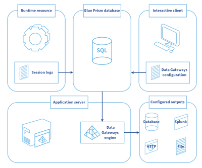

You could look into using our Data Gateways product offering to send output to a (separate) centralized reporting database or a third-party tool like Splunk for analysis.
More information on this can be found in our Product Help here, with a visualization of how it works below:
