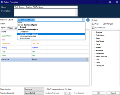

I am currently facing an issue with the Work Queues functionality in Blue Prism version 7.3. In my environment, I am unable to locate the standard "Internal - Work Queues" Business Object that typically contains a set of actions for managing work queue items, including the "Get Next Item" action.

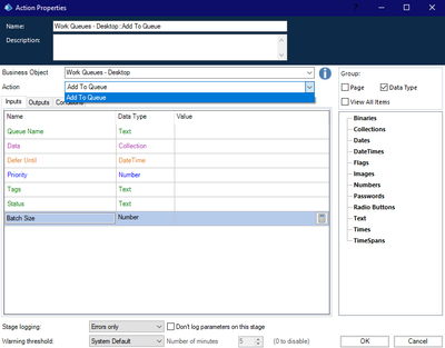

Instead, I only have access to a Business Object named "Work Queues - Desktop," which seems to have a limited set of actions, with only "Add to Queue" being available. This is preventing me from properly retrieving and processing items from the work queues in my processes.
I have attached screenshots of my Blue Prism environment showing the available Business Objects and the actions within the "Work Queues - Desktop" Business Object for your reference. Version of BP 7.3

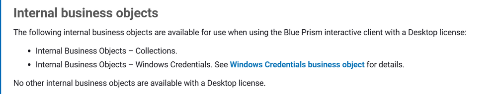

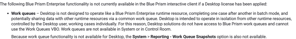

In Blue Prism Desktop, we have a lot of differences from the standard Blue Prism Enterprise functionality which has been mentioned in details here. This clearly states the following point which is why you are unable to see the Work Queues business object:
