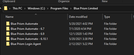

I've had some mixed success when installing multiple versions together on the same machine. As Nathan said, you can choose a different location to install Blue Prism. I do it a little differently though. I always treat the most recent version as the core or standard version installed on my machine. When I go to upgrade, I copy the entire Blue Prism Automate folder and paste it into the Blue Prism Limited folder so that it creates a copy named like "Blue Prism Automate - Copy", and then (let's say I'm installing 6.10.1 from 6.9), I rename the copy folder to like Blue Prism Automate 6.9. And then the one that has no version called like "Blue Prism Automate" is the latest version that I just installed.
I have not put much effort into determining where all this can go wrong. But the main issue I've encountered is that the Connections Configuration file located at C:\ProgramData\Blue Prism Limited\Automate V3 can sometimes get corrupted when switching back and forth. Right now on my workstation at work, I have Blue Prism 6.5.1 and 6.10.1 installed at the same time and seem to have no issues. I can also open both at the same time and edit processes/objects in both versions at the same time.
This is what my personal machine's Blue Prism Limited folder looks like. The one with no version is v7.0.
