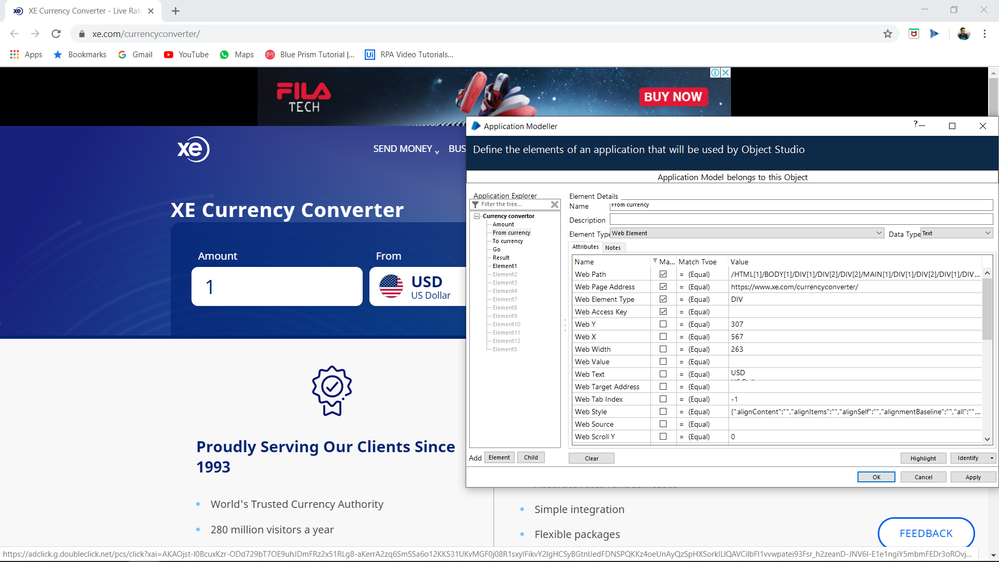

2) For chrome browser, while spying the dropdown field (from) able to highlight it but not able to write the value in it (Since element type is webelement and not an Text edit - tried all possibilities of spying the field (browser mode))

Hello Senthil,
For issue 2, refer to below snapshots, this should give you some pointers.  After doing the following configuration for the element in application modeller, I am able to read the value using Read Stage.

Solution for problem 2 is already given by Bala
