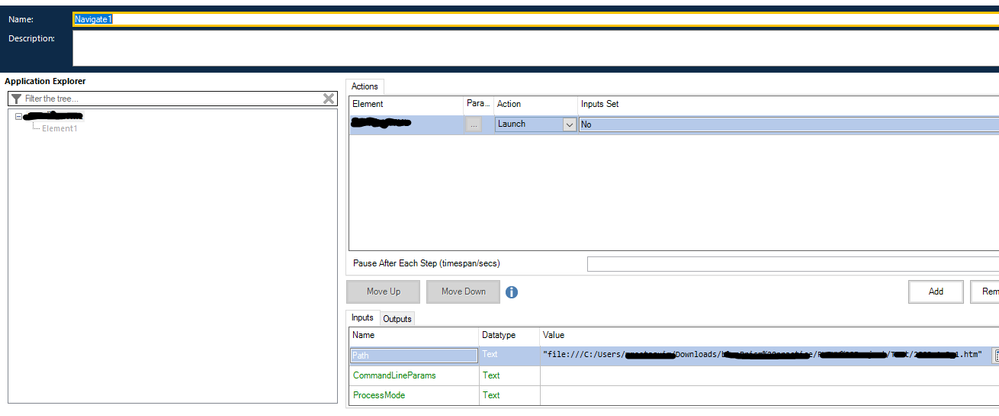

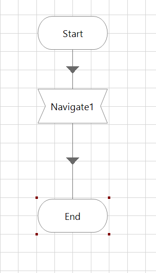

I have downloaded a file from SAP in htm format. Now I need to extract data from the htm file. So, I tried to run Microsoft Edge using Application Modeler. Then I used navigate stage to launch Edge where I specified the path of htm file. Unfortunately, it doesn't work for me. Can anyone provide a suitable solution?

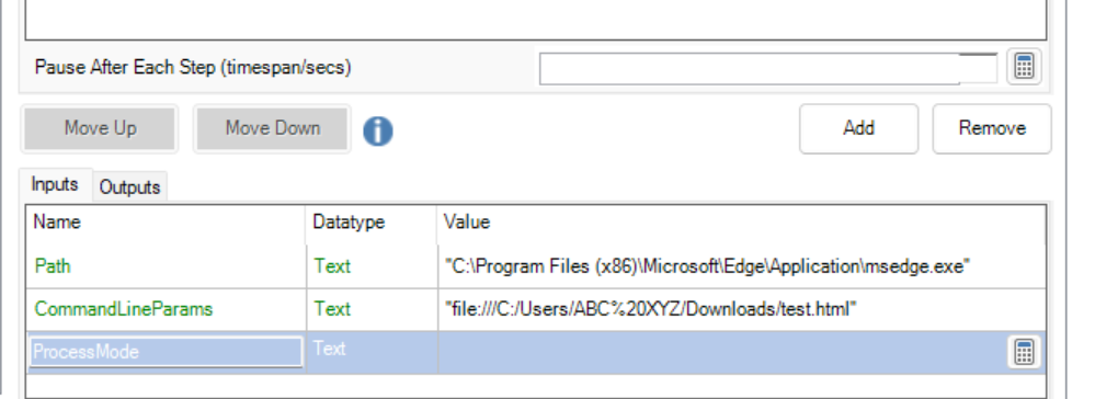

13-07-23 07:46 AM
Hi Ekram,
Try launching as below.
Note that space is encoded as %20 in params
If above works then you may refer https://community.blueprism.com/discussion/browser-mode-not-responding-for-a-webpage-with-html-extension if you have issues with spying
