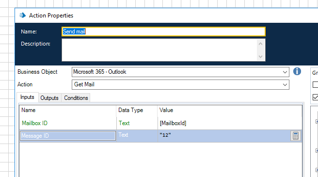

But for reading the mails . I am using the same object with the same authentication (using Client secret). But it is showing as 400 Bad request.
is that again related to the permission setings.
The error that I am getting.

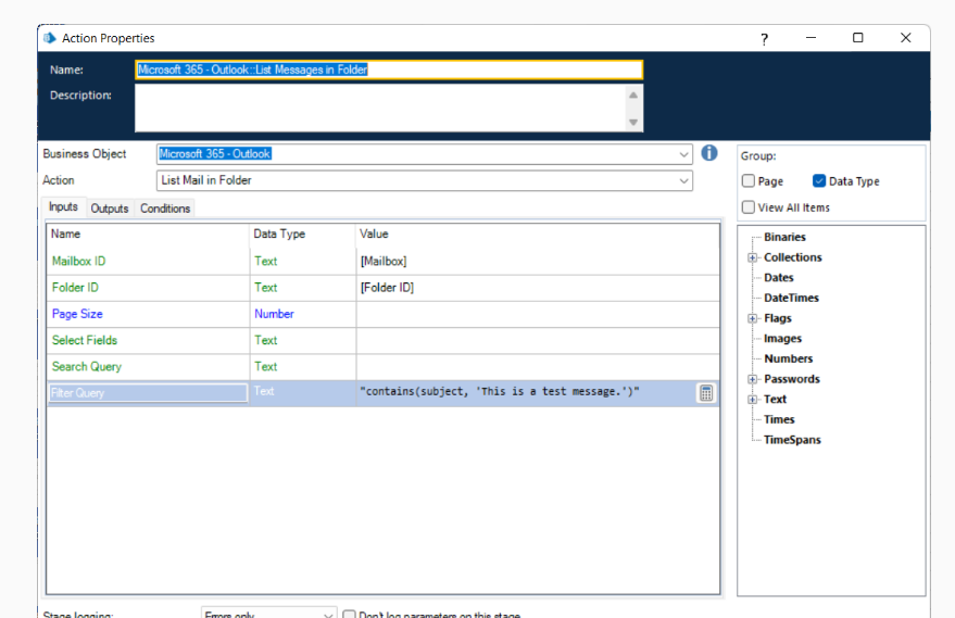

Also I can see , here message id is used. Is there any VBO's which we can use in O365 which reads mail from an outlook mail folder by giving  mail subject
like shown in this below screenshot

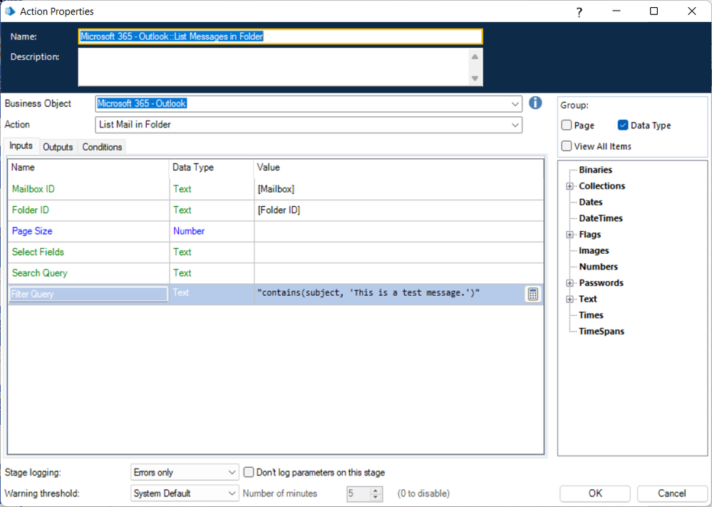

Hi @Hari MR,
Regarding retrieving/reading emails, it could be a permissions issue, but based on the screenshot I'd say it's because you have an invalid message ID. Message ID's in Outlook 365 w/ Graph are usually long cryptic strings like this:
BAMkADdhY2Y2MDE1LTA4OGMtNGVlYy1iZWVlLWE1ZWI3MGMzY2NmNQBGAAAAAAC4m1t2yd3rRLBp6h87n7GsBwCY63neJCDgQ6lEUTrNiFSQAAAAAAEMAACY63neJCDgQ6lEUTrNiFSQAAA14fR9AAA=​​

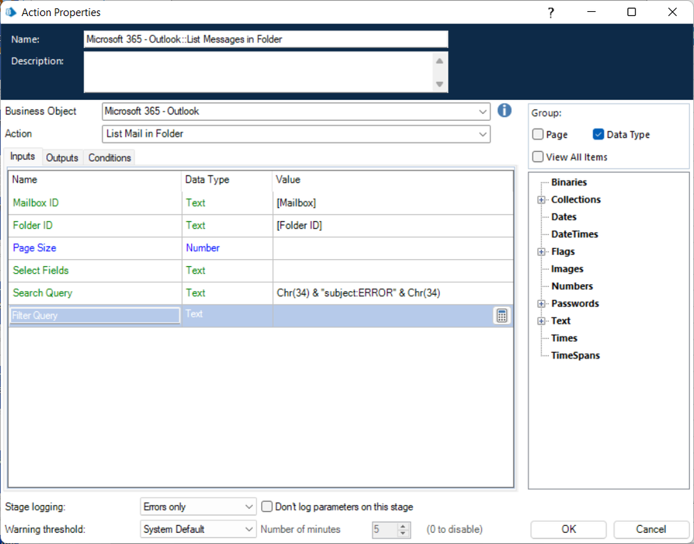

As far as getting emails based on a subject, you should look at the VBO documentation related to the List Mail in Folder action. You specifically want to pay attention to the Filter Query option if you trying to match emails using a sentence or phrase. To get only emails that have a subject line of exactly "This is a test message.", I could use a Filter Query like this:
"contains(subject, 'This is a test message.')"
The Search Query option is a bit different in that it's looking for a specific term within the specified field. So, if I wanted to return a list of emails that contain the term "ERROR" in their subject I could use a Search Query like this:
Chr(34) & "subject:ERROR" & Chr(34)
There's a decent explanation of the difference between the OData $search and $filter features on this Stack Overflow thread, specifically the accepted answer.
https://stackoverflow.com/questions/50939061/what-is-the-difference-between-the-filter-and-search-query-parameters-in-microso#:~:text=This%20is%20indicated%20in%20Microsoft's,could%20be%20returned%20b...
Perfect , Thanks a lot for your help Eric 🙂
Read mail has worked by following the steps you provided.

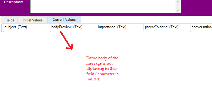

Hi Eric,
Regarding List Mail in folder action, the output is a collection. In the output the body of the email is limited to certain characters, means the whole body of the message is not showing. Bot is fetching details from the body of the email and is then feeding those values to another application. Here the problem is because of the limited character the entire body is not getting populated. and the bot fails to enter the entire info in the application. Is there any way to solve this or to increase the size of that field in the collection?

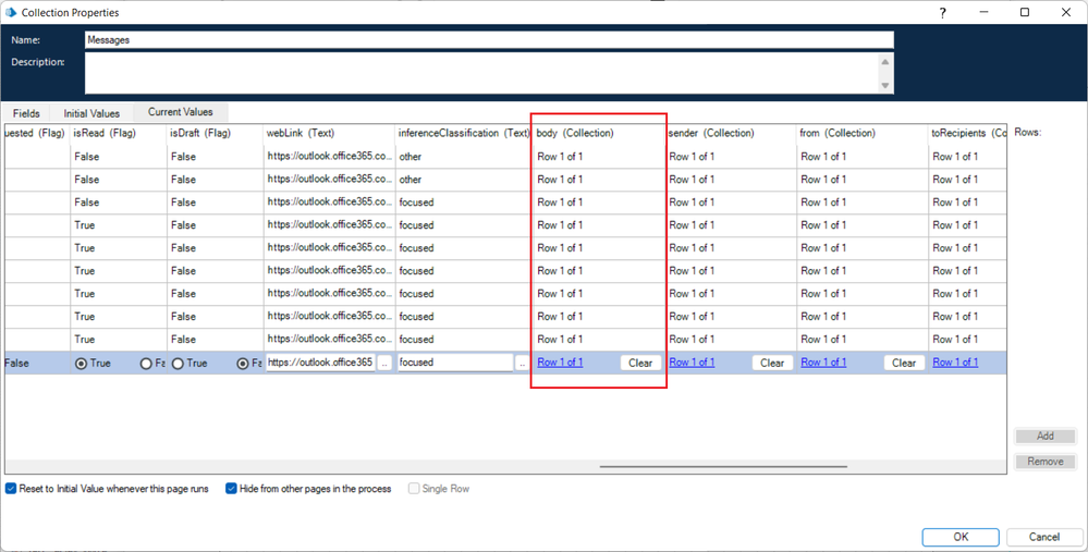

@Hari MR,
You're looking at the bodyPreview field. Microsoft only includes the first 255 characters of the body within that field. You need to be looking at the body field.
The body field contains a child Collection for each message​ with an indicator of the contentType and the actual content. At the moment, I believe Graph always returns the content as HTML.
