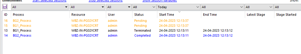

For instance I've a license that has the capability to have 10 concurrent sessions and unlimited number of run time resources. I've created 2 objects in Background mode with a single action in both of them. I now created two different processes with one Background object action called in each, when I tried running both the processes one is getting completed and another is getting terminated as shown in below screenshot.
Though I've the lic capacity to have 10 concurrent Background sessions why is one process getting terminated.

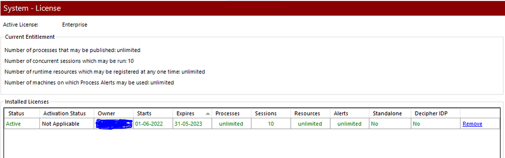

Following screenshot shows my lic capacity:

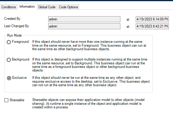

Did you crosschecked the Run modes used in those objects? By default, it is exclusive as shown below.
For Background objects, you to have set the Run mode to Background.
