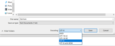

Hi @mmostaquim ,
Change the encoding to UTF-8 like below in Notepad (Save AS):

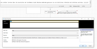

I am using the Read All Text From file Action in the File Management - VBO it works well. Attached is the sample text.

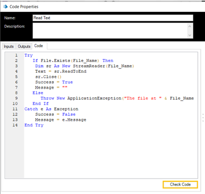

Read Text Code:
Hi @Chakkravarthi_PR,
I have checked the code of Read All Text From file Action in the File Management - VBO. The code is same like yours. For me, text looks like this "Gesch�ftsbereich"
I cannot find out where is the issue.

Hi @mmostaquim ,
