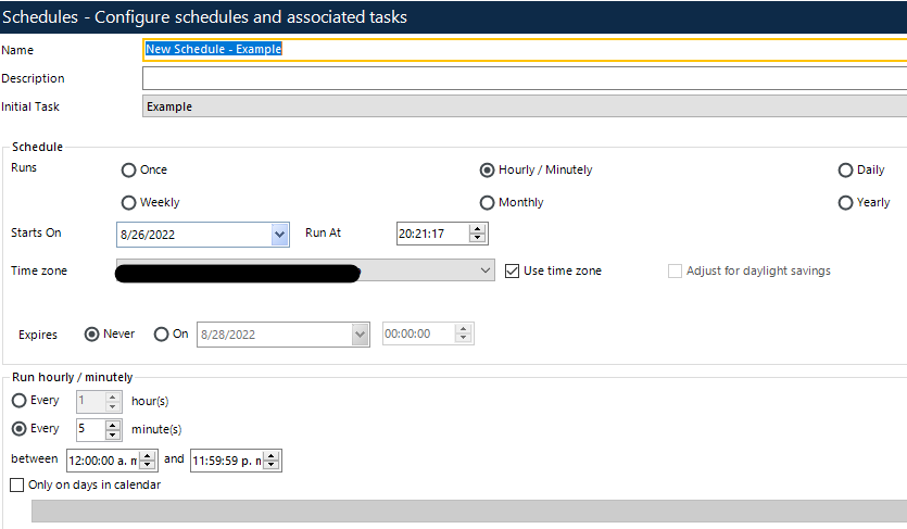

Hope you're doing good. I have a problem with the scheduler, I followed this steps:
-Publish a simple process in the control room.
-Create a schedule which Runs every 5 minutes. I assure the Time Zone is the same as my actual place.

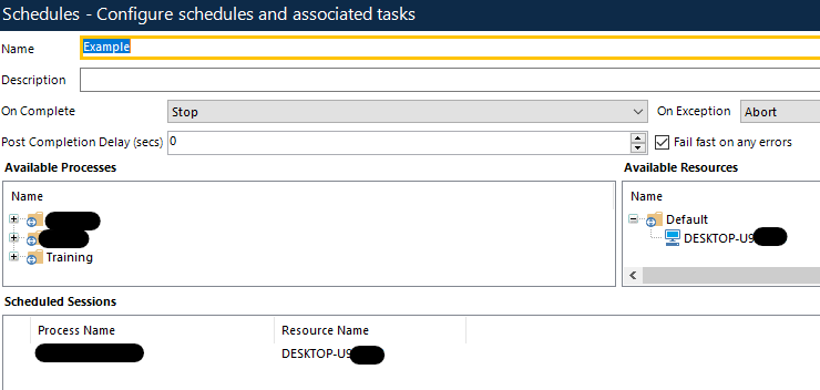

-Inside the previous schedule, I create a New Task which is using the simple process and set up the actual resource.
However, it doesn't Run the process at anytime. I can prove this because in the Session Management doesn't appear the process to be executed.

29-08-22 06:08 AM
The Blue Prism scheduler runs on the application server.
Scheduler is not working in Learning Edition.
