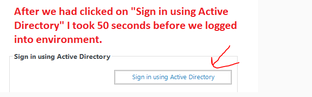

After we upgraded our Blue Prism platform from v6.9 to v7.1 We are having enourms delay when we sign into Blueprism by using a new button "Sign in using Active Directory".
Delay is between 40 - 60 seconds.
