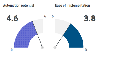

I used the Process Assessment tool to improve our analyzes and definition of automation complexity.
However, I would like to hear a little from you regarding the complexity.
For example: in the image below, the complexity is 3.6 out of a total of 6, in other words, how long is it necessary to carry out this automation?
Or rather at simple (0 - 2), medium (2 - 4) and difficult (4-6) levels, what is the automation delivery time you would use?

Hello @Jrwork - can you click on this button available just below to see the PAT recommendation
also, i don't think you will get development effort from PAT.
Hello, @Neel1
needs to hear from you at Or rather, at the simple (0 - 2), medium (2 - 4) and difficult (4 - 6) levels, what is the automation delivery time you would use?
When clicking on this field, I do not have this guidance, I understand that this is relative between companies, but I would like to hear a little from you
Neel1
Every Org has its different standard and criteria to measure complexity and timelines . some of those are - how many applications are to be used , how many navigation(keystroke, click) are there in applications. In my past org- 4 weeks of development is simple. 4-8 weeks is medium and greater then 8 weeks is complex.
