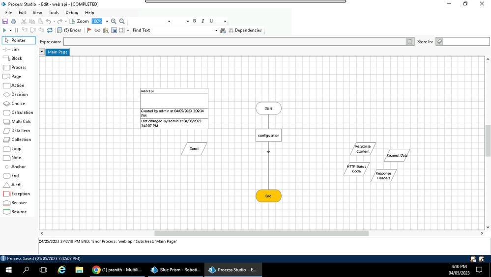

Below is the image which contains the program to call an api to get exchange rates and store it in a respective variable i created.when i started the program it starts with START button and directly skips to the END button.

@PranithPashikan - You missed to link the configuration action stage after the start stage - use link from the side toolbar.

Thanks for the solution.
