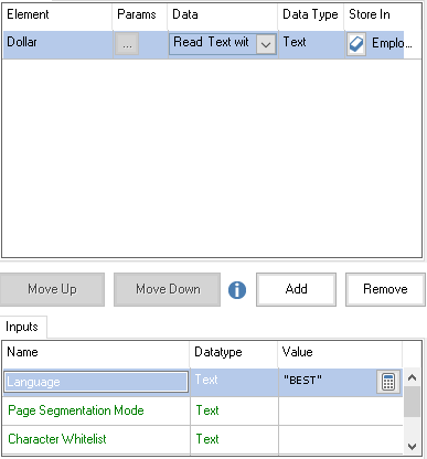

With the new traineddata in place, go back to your Read stage that was having difficulties. Continue using the same object. If you added a new name to the traineddata you will need to call out the new name in the Language section. In my case, it was using the "BEST". If you replaced the traineddata you do not need to make any changes.
![23608.png 23608.png](/t5/image/serverpage/image-id/23741iD1B7842D52635F10/image-size/large?v=v2&px=999)
Having both versions of the traineddata on the machine allowed use to call either version of the OCR engine. If I wanted to use the original version I would specify the Language section with "eng" (everything before the period on the original traineddata file). This has the original Tesseract engine work on the OCR. If I wanted to new version I would set the language to "BEST".
