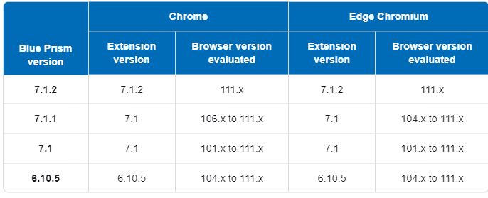

As per the existing Browser extension Compatibility doc below, these versions of Blue Prism are compatible till 111.x.x of the Browsers as mentioned. Now, the Browser version were recently updated to 112.x.x as found in chrome and Microsoft Edge. So, can I consider that 112.x.x will also be compatible with these versions of Blue Prism or have to roll back to 111.x.x version to make Browser mode work properly?

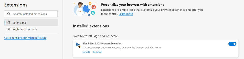

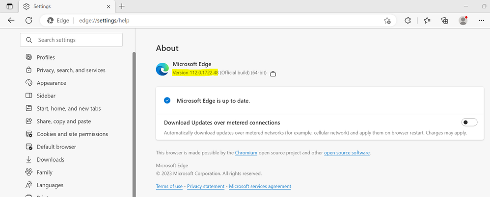

Hi @esaugos - We are already using 112.0.1722.48 Edge Browser with Blue Prism 6.10.1 as you can see in the below snippet and its working all good for us without any issues at all.
