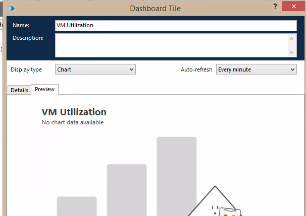

I am trying to create a Tile in the Analytics window to see the daily resource utilization as shown below.
But m not able to get the desired results. The Preview is blank as checked.

Hi Saurabh,

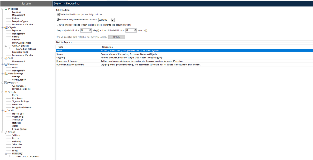

The BPDS_DailyUtilisation data source requires the MI Reporting functionality to be enabled, this can be done in System --> Settings --> Reporting as can be seen below.
It is also worth noting that this will only show results from when the setting was enabled. It will not back date the data. I suggest enabling this setting, and reviewing the tile the following day.

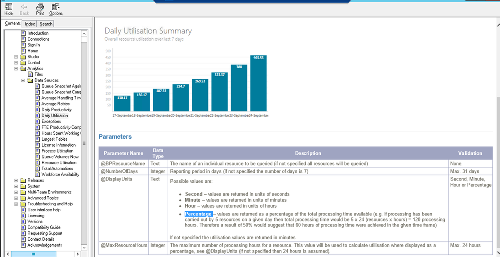

Hi Saurabh,
The BPDS_DailyUtilisation data source requires setting to do.
But in case just refresh the title or remove all title and then drag and drop you tiles with desired inputs
Hope it helps . Just pasting the reference for inputs.
