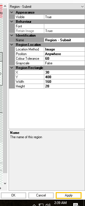

I am using region mode to spy  one of the website in Microsoft edge.
The Process runs fine in my machine but when i highlight in another machine it highlights some other region than the actual region.
Below are the steps i tried.
a. I Spied as fixed
b Tried as Anywhere
c. Kept color tolerance. to 60
d .have unchecked the smooth edges
Note :Both the machine has same screen resolution
Application modeler screen shot
Nagarathna Heggade
[email protected]
Nagarathna Heggade
Dear Nagarathna,
In the mentioned scenario, location method as Image is fine since you are checking for a submit (assuming it is a button and is static).
But could you please choose Position as 'Fixed' rather than 'Anywhere' and keep the search padding as default.
This should locate the submit button within the padding area.
With Position as 'Anywhere', at run time it searches the entire region.
Please change as suggested and check if it has solved the issue.

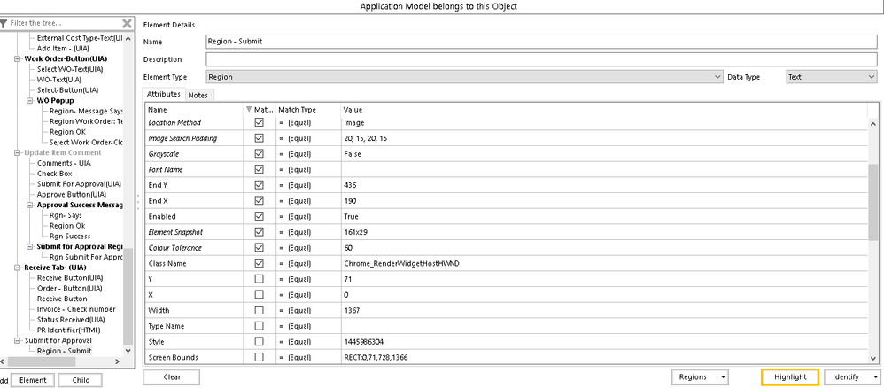

NagarathnaHegga
Thank you Ramneet Chawla for Looking into it.
Could you please help me understand where i can set it as default.
Nagarathna Heggade
Hi Nagarathna,
Please note while you are selecting a region, please keep position as 'fixed' and keep the search padding with whatever values selected.
Attaching the snippet for reference.
Ramneet
