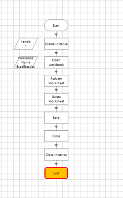

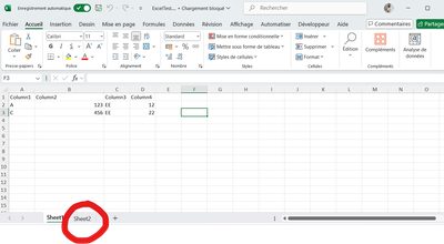

Suppose i have this excel file and i want to delete Sheet2
Drag and drop an action and go to MS Excel VBO
- Create Instance
- Open Workbook
- Activate Worksheet
- Delete Worksheet
- Save
-Close
- Close Instance
Your Flow should look like this :
Try it and let me know 😉

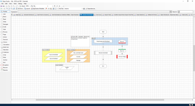

Below are some screen grabs so you can see whats needed, not the checkinstanceandworkbook stage are optional its not required.

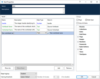

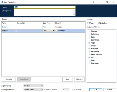

input on the start stage
Action flow
Code stage inputs

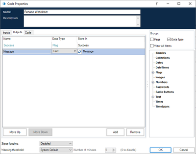

Code stage outputs
End stage outputs
Hope this helps 🙂

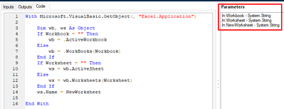

Hi Joanne - it's best not to edit the original Excel VBO, so make a new VBO for your bespoke actions. Add a code stage like this, with workbook name, worksheet name and new worksheet name as inputs. The logic below makes the workbook and worksheet names optional, where the active workbook or worksheet is used if no name is specified. The code also assumes the workbook has already been opened (probably by the default Excel VBO).
With Microsoft.VisualBasic.GetObject(, "Excel.Application")
	Dim wb, ws As Object
	If Workbook = "" Then
		wb = .ActiveWorkbook
	Else
		wb = .WorkBooks(Workbook)
	End If
	If Worksheet = "" Then
		ws = wb.ActiveSheet
	Else
		ws = wb.Worksheets(Worksheet)
	End If
	ws.Name = NewWorksheet
End With
