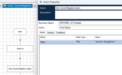

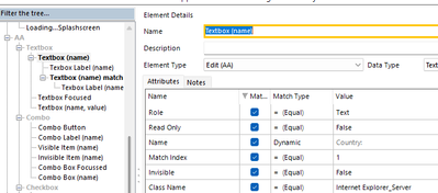

Although it was quite some years ago, my memory of integrating SAP web was that it was not at all easy, so much so that we also abandoned the use of browser mode. UIA mode did not exist but we found that AA mode worked well, and because most elements had Names (or IDs) you could easily find, we were able to create a VBO with basic actions like Click Button and Write to Textbox that used generic elements with dynamic attributes.
We then created VBOs that had no App Model and instead called the actions of this base object.
This 2 layer VBO approach proved successful and was the basis of many processes.
