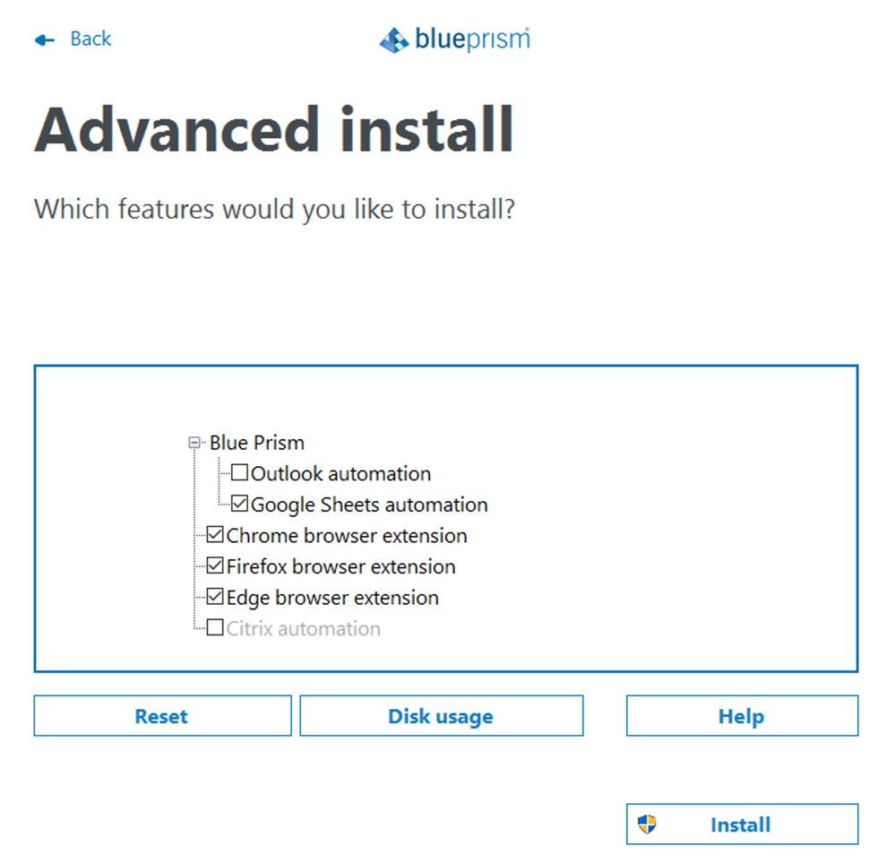

I signed up to the BP trial and got a link to download v7.0.1. I want to expose a Blue Prism bot as a SOAP service so that it can be invoked from an external source. Apparently the SOAP service should be available at http://[machine name]:[port]/ws/ but there doesn't appear to be anything running at this endpoint. Is this possible with the trial version and do I need a separate installer to install the SOAP service? The advanced install option does not provide an option to install the SOAP web service as per below.

Hi @YogeshMudaliar,
You can expose any process or VBO in your environment as a SOAP service. Once you do that, you should see it listed on the WS page you referenced above.
To publish a process or object you need to go to System -> Process or Object -> Exposure. From there you can select what you want to expose with just a few clicks.
