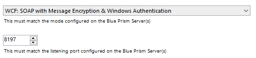

Our environment is configured with the following form of authentication:
If you need any more details just ask, I'm waiting for any suggestions to solve the problem :)
