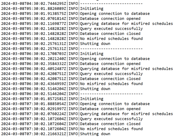

I then setup the schedule monitor to run via task scheduler once an hour. I've confirmed it is running by checking the logs. My issue is that every hour it runs, it is seeing no misfires since that last runtime, even when there are misfires.

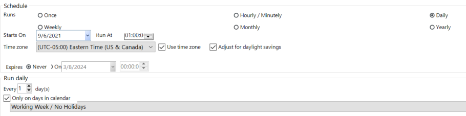

My thinking is that it could have something to do with time zones although I've checked the time zone on the database and app server, and both are in UTC. I've queried the BP database BPASchedule table and see one of the processes that should have triggered the monitor to record a misfire. This particular schedule is setup to run at 1:00 AM Eastern time from the scheduler menu. Looking at the BPAScheduleLog table, I see that the instancetime is 1AM (EST -5 from UTC), but the heartbeat time is 6 AM (UTC).
Could it be that the schedule monitor is relying on the instance time which in many cases in my environment is set in Eastern Time, but is querying in UTC causing the monitor to miss these misfires?
Any other thoughts as to why the misfires are not being caught?
