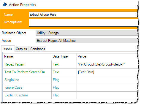

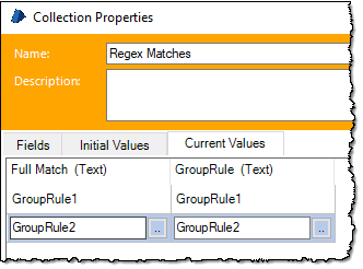

Try substituting another character for CRLF first, eg Replace(Replace([Text from Excel], Chr(10), ""), Chr(13), "#"), and then pass the result to the Split action, using the same split character, eg #.
Obviously the assumption here is that # doe snot already exist in your cell text.
